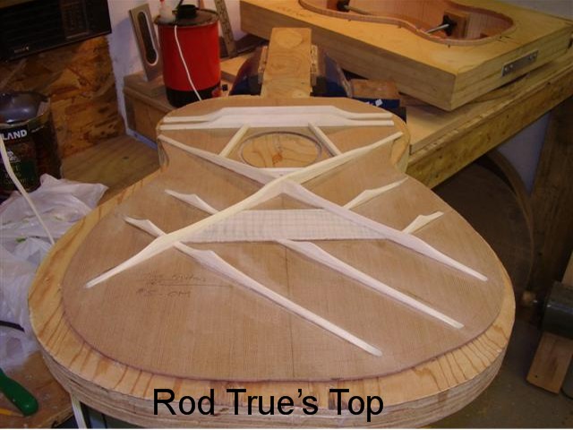

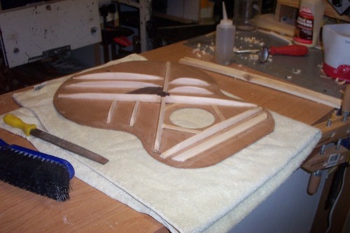

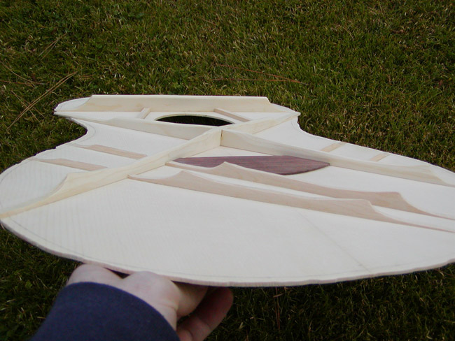

I just wanted to see this up on the forum again as it already archived. This top is very interesting for several reasons.
1. The lower tonebars are single-peaked. I'll swear they had scallops on there the first time I looked. So that really is a serious but cool-looking mod.
2. The lower part of the main X-brace is not inlaid into the sides, they are tapered away like a tonebar or finger brace. I take mine all the way through and perch it on the sides and linings. I know others do this too. Anyone had a main x pop loose due to this?
3. It has a double transverse brace under the fingerboard area. I do this too, primarily because I was following Hoffman and he does this. Plus, the Martin kit blueprint also shows two. It's an old design and prior to adjustable truss rods. Not a problem for me because I use a head adjusting rod.
4. The bridge plate is large on this bracing scheme. My guess is it's an attempt to eliminate belly bulge? I think this might dampen a top somewhat, just the weight alone. Then it could also dampen it structurally, gee this has got to be really really strong.
5. The last thing is, similar to Olson, the upper tonebar dies into the bridgeplate. It just about has to, I guess you could run it onto the maple plate? That would make replacement difficult.
Overall, a very interesting bracing scheme Rod. Always neat to see another builder's work.
PostPosted: Thu Jan 04, 2007 8:34 am
Wow, feeling a little bit naked right now
Of course I'm open to comments both negative and positive if you've got them.
I really can't give any reasoning for bracing the way I do other than this is how one of my own personal guitar builder idol's does it.
I've always liked the sound of Olson guitars and have spent a little bit of time talking with Jim about how he does things.
Mine is a little different than Jim's in that I didn't scallop the tone bars, but this helped open up the top when tapping it, so I went with it. This top sure had the best sound when tapping versus the other's that I've done this way (this will be the 4th to date). The other difference with this top versus the other's I've done and what Jim does is that I'm not letting the lower X-brace arms into the linings (This is something that I got from Paul Woolson, so it's his fault )
I wish I could give more reasoning to you, but I can't. I will continue to brace this way till of course like most builders, find something that works better for me. I am also very very interested in learning for Ervin's weekly tutorial here on the OLF regarding voicing the top. Sure wish I could give up some time to take the week long class, but the day job, mortgage, young kids etc... just won't happen. Please stay with us for a very very long time Ervin, I want to take your class sometime in the next 10-15 years
I guess everyone draws a line in the sand and this so far is what I've done for that line.

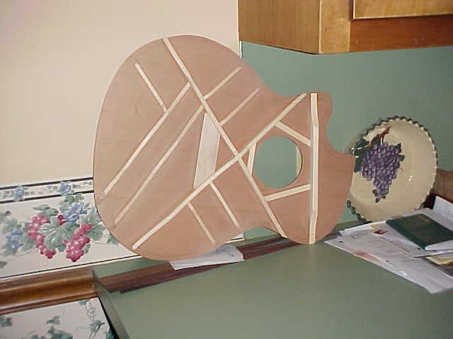

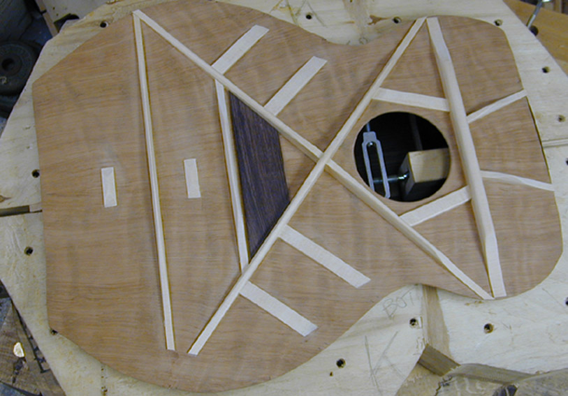

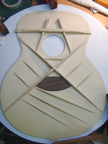

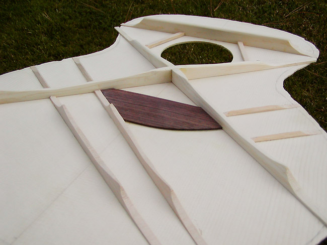

Here is a picture of the bracing on guitar #4 it's a cutaway so the upper transverse brace is cut short to get into the side.
After this picture was taken, I shaved more off the tone bars, almost to the same shape as the first picture Bruce posted.
Can I get my cloths back on now Rod True39086.6943287037
PostPosted: Thu Jan 04, 2007 9:24 am
Thanks Rod for the second picture. Did you taper the main x'es on this or let them in? So Woolson likes his tapered. Well, if Woolson does it, then that may be a CFox innovation? Maybe he'll chime in.
I was thinking along the lines of what overall effects each of these mods have on a guitar top? Plus, your top is interesting. Mine are boring basically.
On the ones I've done with cutaway, I've angled that second transverse brace to miss the linings. That's a little tricky, but it works. I like having it in there.

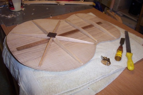

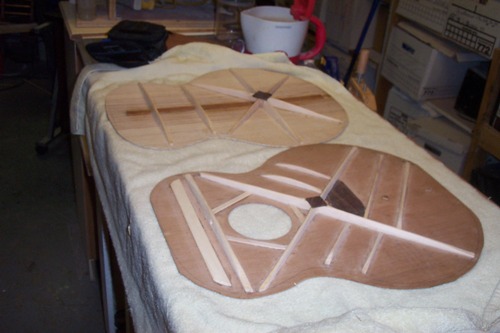

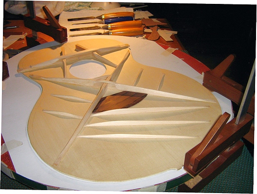

WOW Great thread Bruce, i hope you're all ready for Bear without fur?
I learned a lot from Rod, Hesh, Paul and others but my last revelation was Colin Symonds' way of shaving down my braces, i went with parabolas to copy on Hesh and with Colin's help, oh my, what a difference in opening up it made! This is guitar no 3 for my Godfather Norman.
Here are 2 pics, the back and the top prior to receiving Colin's instructions
And after
the box is closed now and is feather light and taps so live that i just can't wait to have them strings on!

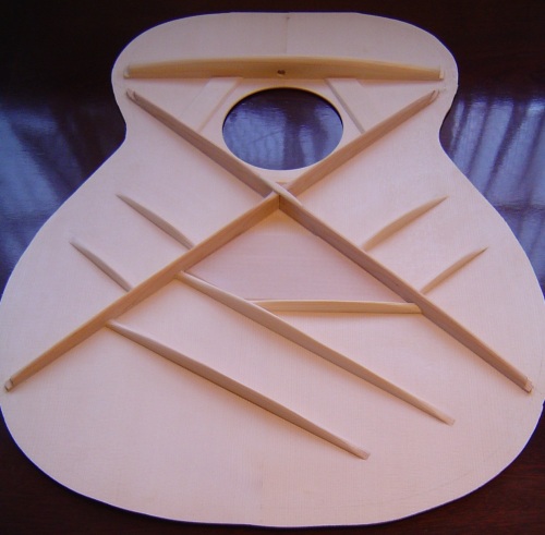

Here is the second last one I completed ... went for wider than normal fingers as the this was redwood, probably no heavier than anyone elses pointy thin ones. This one was full and even once done, and had sustain for days (went on a 15.5 lower bout EI rw design of mine) Bridge was braz rw.
PostPosted: Thu Jan 04, 2007 10:38 am

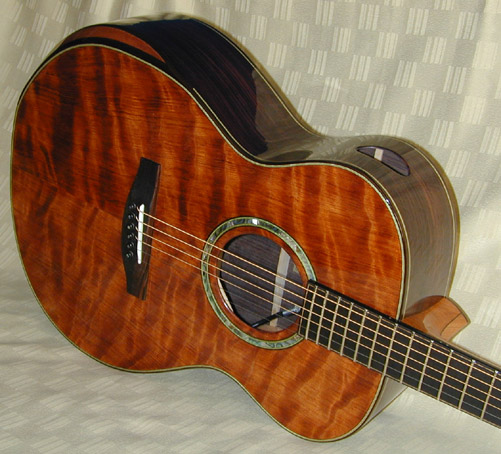

I figure someone will ask .. so here is the finished product (I wish I had taken these with the new camera, oh well) ... redwood armrest, green ab rosette, maple green maple purf, ei rw bindings. I forgot to mention in the upper post that the two bass side braces end as they do as they are tucked into the armrest piece.

Wow Tony, that's gorgeous!

Tony - ....Oh My!
What a magnificent creation!
Id love to hear a soundclip of that sweetie!

Tony: Just beautiful work! Is that a spruce cap glued on one of the braces over the X intersection? Are the transverse braces in the lower bout symmetrically shaped in a non-armrest guitar? And last, is that a pickup cable or some carbon fiber thingy that I can see through the soundhole?

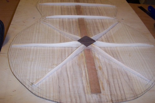

I recently posted these pics of my 12 string build bracing , but for those who missed it;

Yep, spruce cap always .. see the Ervin videos, its highly recommended .. thats what makes the brace whole again once the lap joint is cut. Judy Threet supposedly did some tests and she says that it can be as thin a 1/64th .. I dont know about going that low, but I will certainly be trimming mine down to about 1/16 max.
Yes, I make the braces symmetrical if its a non armrest, these are still the same height at the centre, as if it where a std guitar, but then I shave down to meet the rest block. I may in future be shaving to nothing in the lower bout, untucked ala Mario/Woolson.
What you see thru the soundhole is the mic of a K&K trinity system.

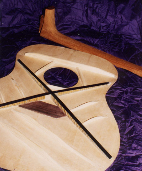

Here's an oddity on my 1st guitar built about 12-13 years ago. Naturally I still have this guitar and it's really great sound wise. I often wonder why I haven't pursued this style more. Every one how hears it really like it. I might come back to play with more some day.
The X is nomex honeycomb wit carbon fiber skins. It was a lot of work.

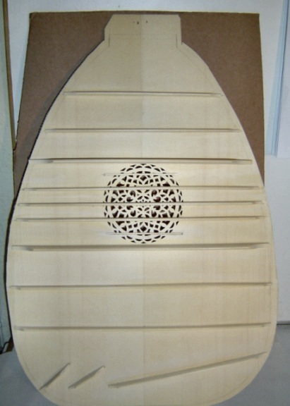

This is my usual type of bracing, I gave up on pointy bits a long time ago. They do have their place, just not on the type of guitar that I like. X brace is 15mm.
This is the bracing I use on my Heiber style lutes.
